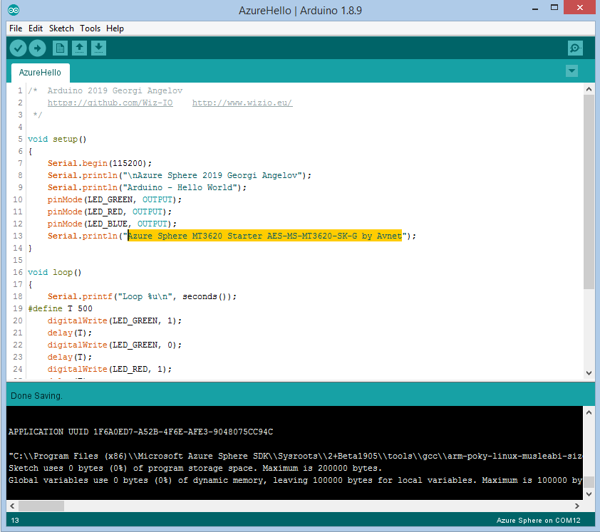

Azure Sphere 2019 Georgi Angelov
Arduino - Hello World - PlatformIO
Azure Sphere MT3620 Starter AES-MS-MT3620-SK-G by Avnet

OLED-I2C ( Arduino )
