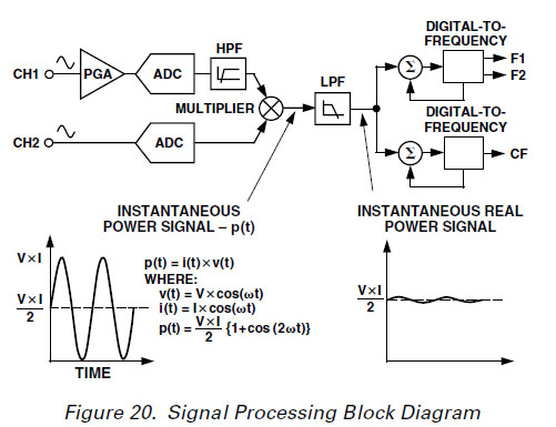

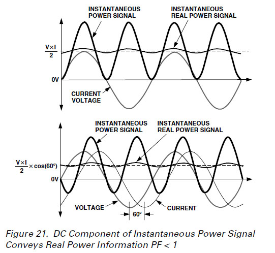

Така пише в документа на AD7755
The real power calculation is derived from the instantaneous
power signal. The instantaneous power signal is generated by a
direct multiplication of the current and voltage signals. In order
to extract the real power component (i.e., the dc component),
the instantaneous power signal is low-pass filtered. Figure 20
illustrates the instantaneous real power signal and shows how the
real power information can be extracted by low-pass filtering the
instantaneous power signal. This scheme correctly calculates real
power for nonsinusoidal current and voltage waveforms at all
power factors. All signal processing is carried out in the digital
domain for superior stability over temperature and time.
fig21.jpg [ 98.47 KiB | Прегледано 4066 пъти ]
Fig20.jpg [ 76.69 KiB | Прегледано 4066 пъти ]
Вниманиене съмвишист....ИЙ.
