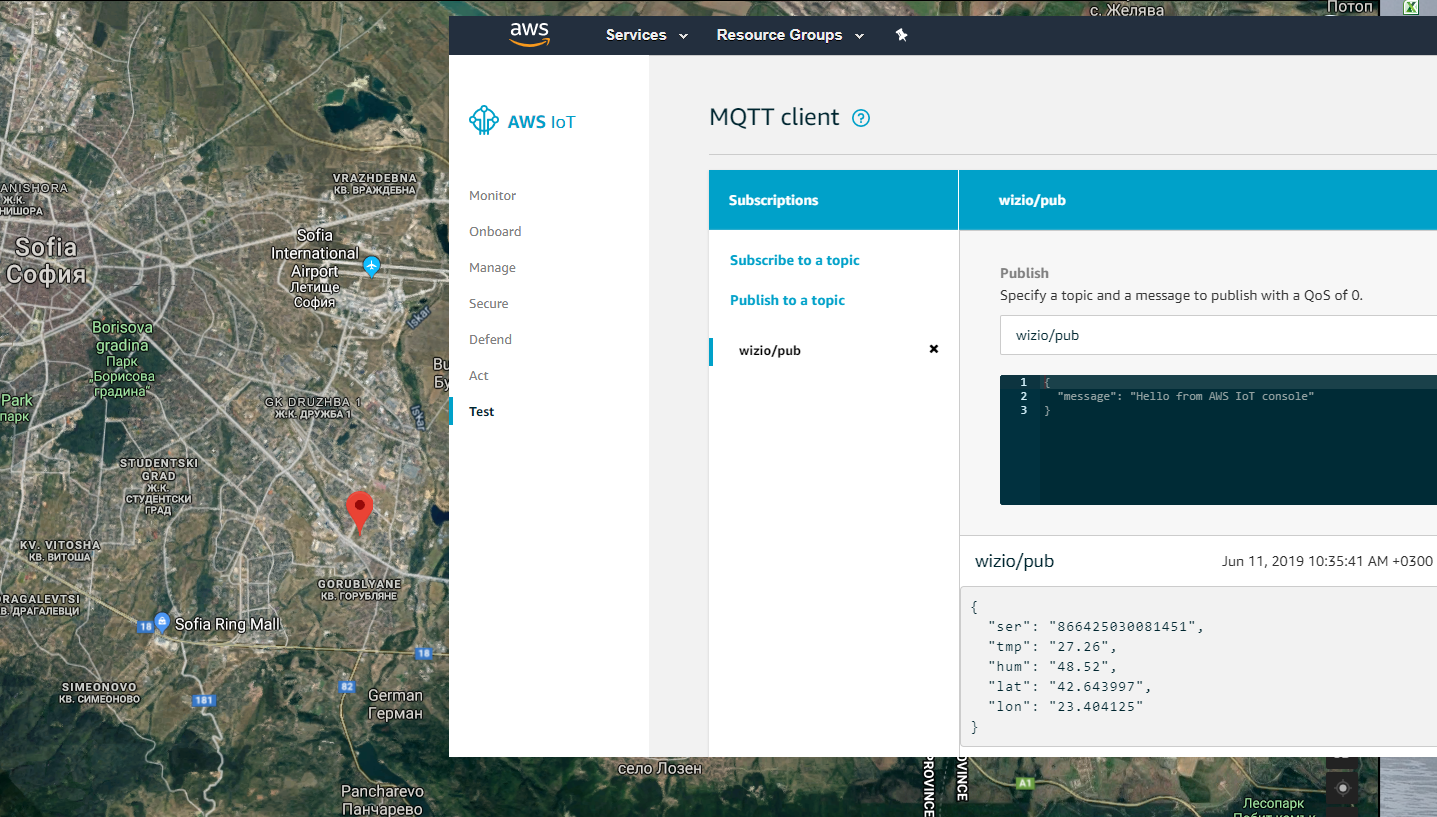

горното с добавен GSP
пример
#include <Arduino.h>
#include <Device.h>
#include <Dss.h>
#include <Ril.h>
#include <txDns.h>
#include <Wire.h>
#include <NMEA.h>
#include <txMqtt.h>
#include "MQTT_CONFIG.h"
NMEA nmea;
MqttClient mqtt;
String IMEI;
void sensorInit();
float readTemperature();
float readHumidity();
Ril ril(QAPI_AT_PORT_1);
static void ril_callback(qapi_at_pipe_data_t *data)
  ril.save(data->data, data->len);
Dns dns;
Device dev;
String iface;
int dataCallReady = 0;
void onDssConnect(void);
Dss dss(onDssConnect);
  IPAddress local, gateway, primary, secondary;
  dss.getIFace(iface);
  dss.get(local, gateway, primary, secondary);
  //Serial1.printf("[DSS] IFACE     %s\n", iface.c_str());
  Serial1.printf("[DSS] LOCAL     %s\n", local.toString().c_str());
  Serial1.printf("[DSS] GATEWAY   %s\n", gateway.toString().c_str());
  Serial1.printf("[DSS] PRIMARY   %s\n", primary.toString().c_str());
  Serial1.printf("[DSS] SECONDARY %s\n", secondary.toString().c_str());
  dns.start(); // and set DNS client
  dns.add(DNS_V4_PRIMARY, "8.8.8.8");
  dns.add(DNS_V4_SECONDARY, "8.8.4.4");
  dataCallReady = 1;
struct minmea_sentence_rmc rmc;
void onNMEA(char *line)
  switch (minmea_sentence_id(line, false))
  case MINMEA_SENTENCE_RMC:
    if (minmea_parse_rmc(&rmc, line))
      //if (rmc.valid) Serial1.printf("GPS: LAT = %f, LON = %f\n", minmea_tocoord(&rmc.latitude), minmea_tocoord(&rmc.longitude));
void onMessage(qapi_Net_MQTT_Hndl_t mqtt, int32_t reason,
               const uint8_t *topic, int32_t topic_length,
               const uint8_t *msg, int32_t msg_length,
               int32_t qos, const void *sid)
  DBG("MQTT Receive\n");
  DBG("   Topic: %.*s\n", topic_length, topic);
  DBG("   Message: %.*s\n", msg_length, msg);
void publish()
  char buff[256];
  float T, H;
  T = readTemperature();
  H = readHumidity();
  //Serial1.printf("SENSOR: Temperature = %f, Humidity = %f\n", T, H);
  snprintf(buff, sizeof(buff), "{\"ser\":\"%s\",\"tmp\":\"%.2f\",\"hum\":\"%.2f\",\"lat\":\"%f\",\"lon\":\"%f\"}",
           IMEI.c_str(), T, H, minmea_tocoord(&rmc.latitude), minmea_tocoord(&rmc.longitude));
  if (mqtt.pub("wizio/pub", buff, strlen(buff)))
    DBG("MQTT Publish: %s\n", buff);
void setup()
  Serial1.begin(115200);
  Serial1.debug();
  Serial1.println("\nArduino Quectel BG96 - MQTT");
  ril.begin(ril_callback);
  ril.send("AT+QCFG=\"nwscanmode\",1\r\n", NULL); // only gprs
  ril.send("AT+QSCLK=0\r\n", NULL);               // disable sleep
  dev.getIMEI(IMEI);
  Serial1.printf("IMEI: %s\n", IMEI.c_str());
  dev.waitSim();
  nmea.begin(onNMEA);
  Serial1.println("Sim ready");
  sensorInit();
  //return;
  dss.apn("gprs", "user", "pass");
  dss.open(RADIO_UNKNOWN);
  dss.begin();
  while (0 == dataCallReady)
    delay(100);
  Serial1.println("Net ready");
  IPAddress MQTT_IP;
  if (dns.query(MQTT_HOST_NAME, MQTT_IP))
    mqtt.server((uint32_t)MQTT_IP, MQTT_PORT);
    mqtt.client(IMEI);
    mqtt.onMessage = onMessage;
#ifdef MQTT_SECURED
    mqtt.secured();
    mqtt.certificate(SSL_CERT_FILE_NAME, SSL_KEY_FILE_NAME);
    Serial1.print("Amazon ");
#else
    Serial1.print("Eclipse ");
#endif
    Serial1.println(MQTT_IP);
    Serial1.print("MQTT Connecting...");
    while (!mqtt.connect())
      Serial1.print(".");
      delay(60000);
    Serial1.println(" Done");
    mqtt.sub("wizio/sub");
    publish();
void loop()
  static int t = 0;
  if (seconds() - t > 60) // publish interval in seconds
    t = seconds();
    publish();
  delay(1000);
GPS-AWS.png [ 1.12 MiB | Прегледано 6777 пъти ]

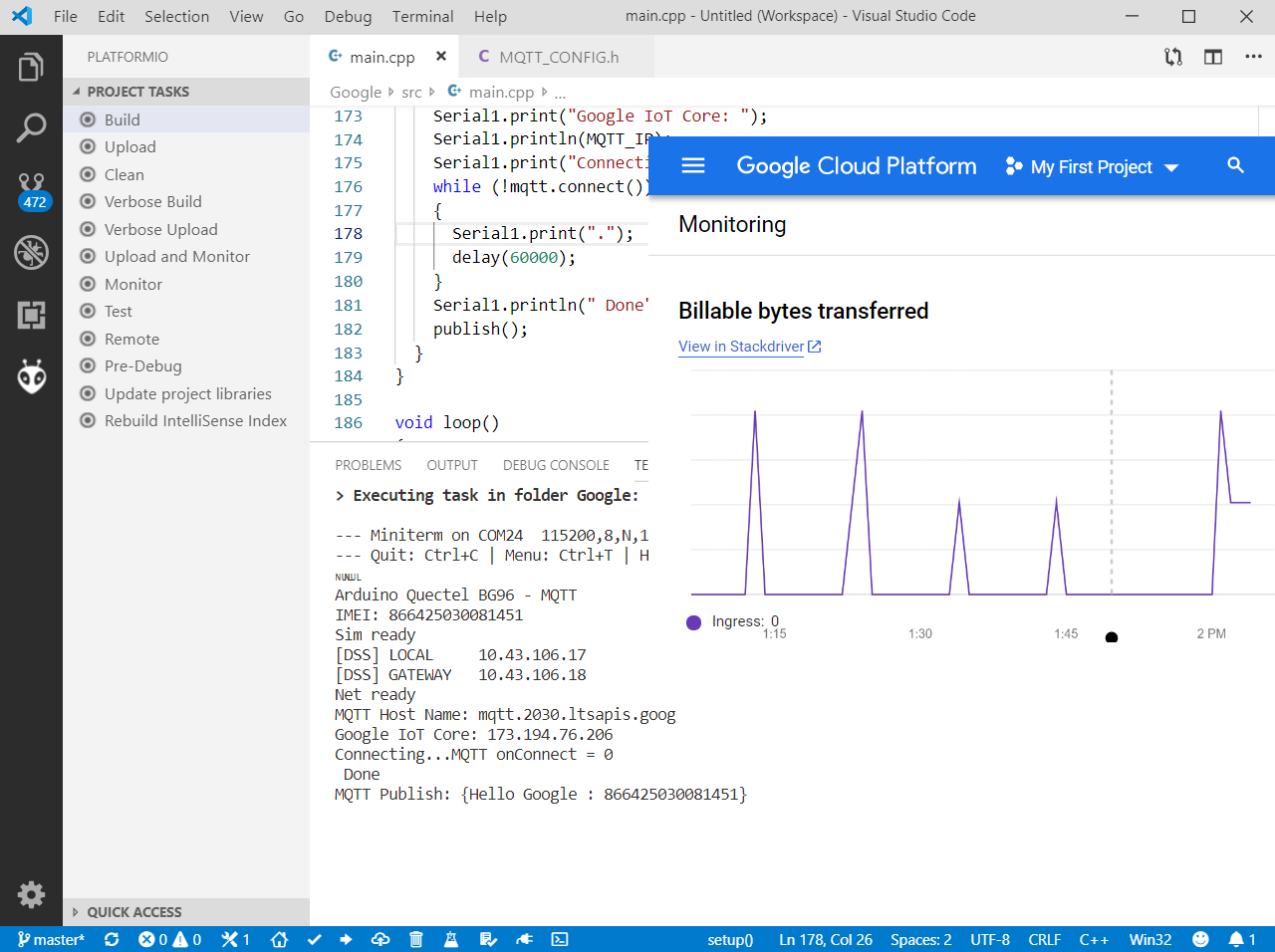

след едноседмична заигравка с облаци
google iot core.png [ 136.33 KiB | Прегледано 6711 пъти ]

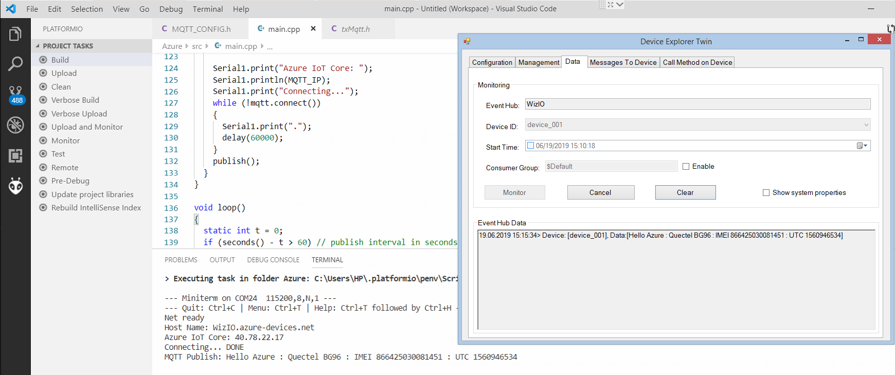

и Microsoft Azure IoT Core "падна плячка"
AZURE.png [ 231.4 KiB | Прегледано 6671 пъти ]

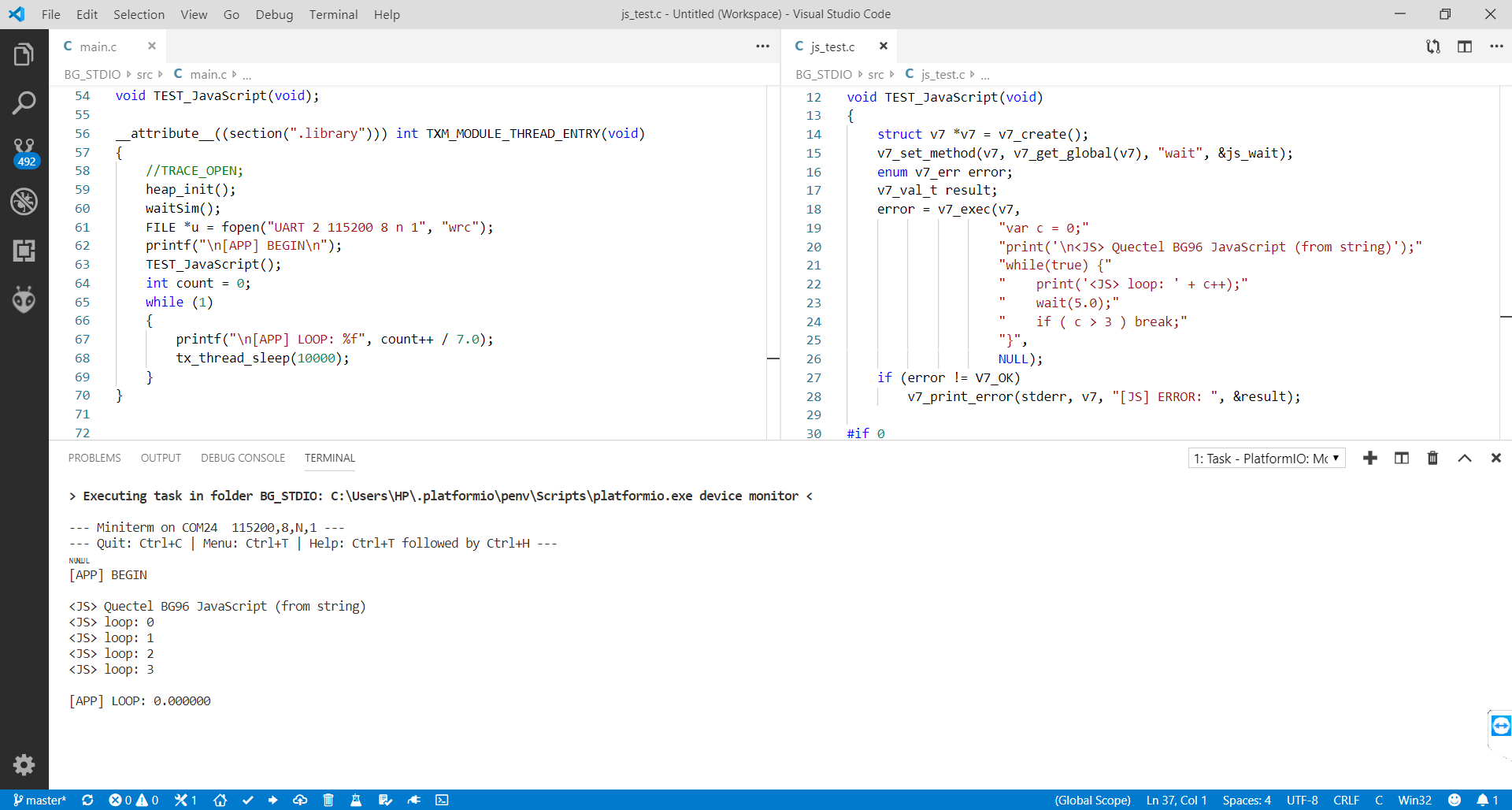

проби... JavaScript с Quectel BG96 ( ThreadX ) :) :) :)
PS: тръгна и от файл, снимката е от стринг
BG96-JavaScript.png [ 92.81 KiB | Прегледано 6411 пъти ]

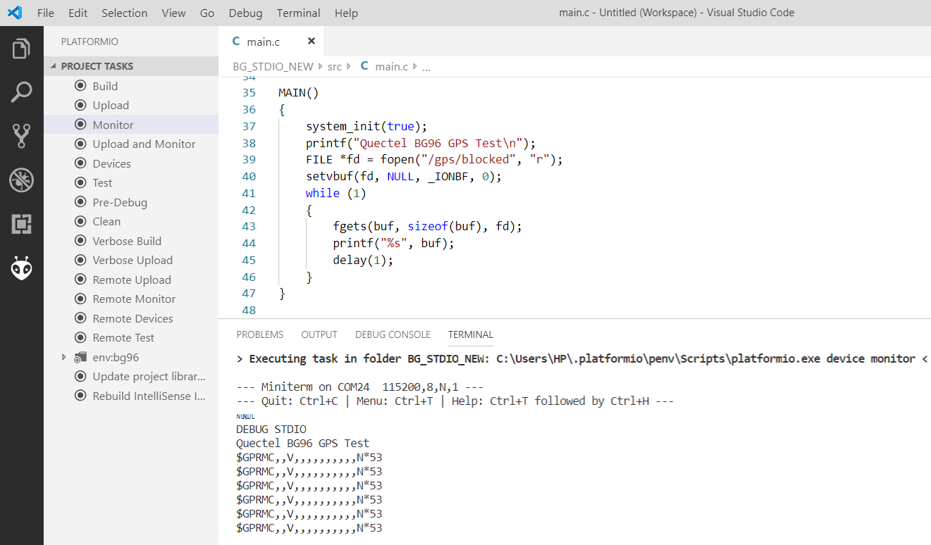

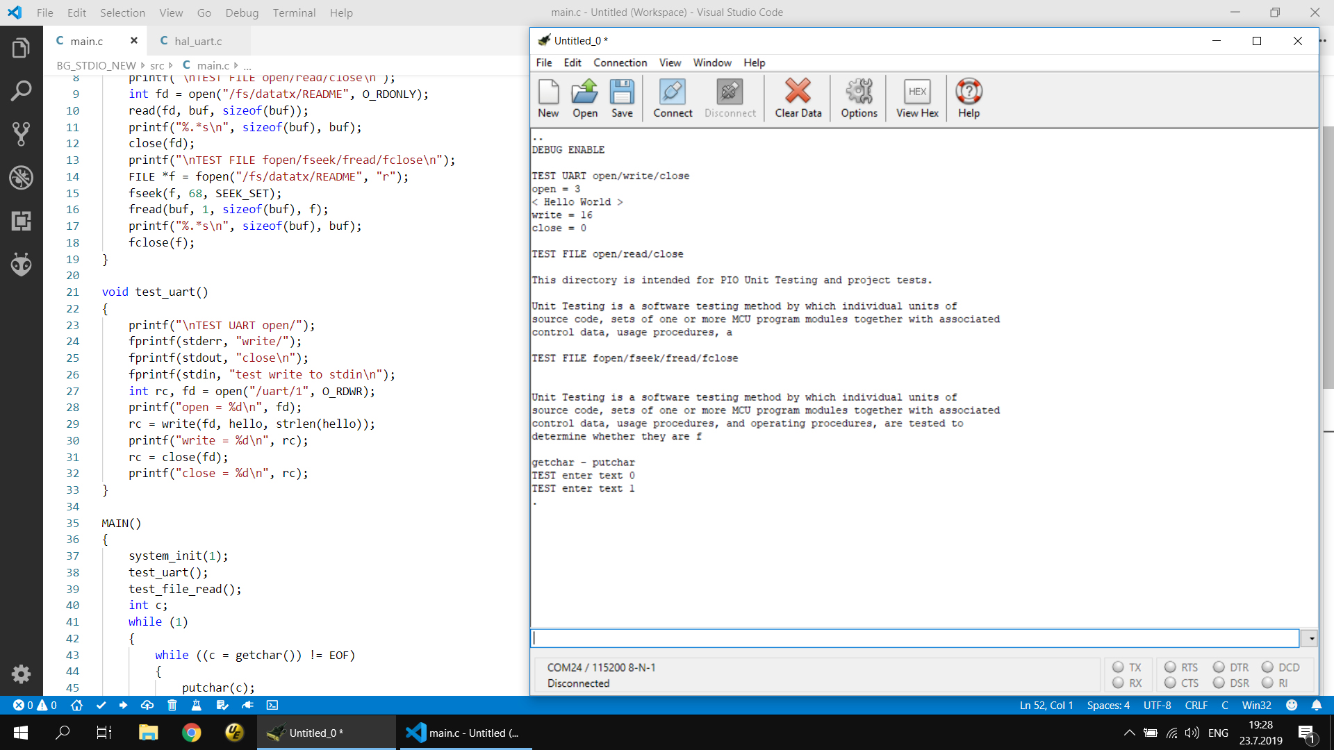

резултат от друга тема ( newlib - stdio линк )
приложена към Quectel BG96 - ThreadX User API ( снимката ) ( app size 54 k от 3 меги макс ) { 20 k ми взима printf full }
пример за GPS ( stdio )
#include <interface.h>
char imei[16] = {0};
char nmea[128];
MAIN()
    system_init(1);
    read( open("/dev/sim-ready", 0), 0, 0 ); // wait ready
    read( open("/dev/imei", 0), imei, sizeof(imei) );
    printf("IMEI: %.*s", 15, imei);
    FILE *gps = open("/gps", 0);
    while (1)
        if ( fgets(nmea, sizeof(nmea), gps) )
            puts( nmea );
        delay(100);
quectel-bg96-stdio.jpg [ 863.92 KiB | Прегледано 6344 пъти ]

на горния пост GPS-a
unix-like.png [ 86.82 KiB | Прегледано 6302 пъти ]
