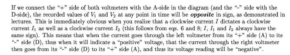

Не виждам, къде казва че волтметрите са свързани в ТОЧКА A и ТОЧКА D.
side.png [ 93.87 KiB | Прегледано 7507 пъти ]

В този текст не, но в коментар под видеото казва, че са в една точка:
The demo I show has become a classic - it is shown all over the world. Two identical voltmeters connected to the same 2 points in a circuit show very different values and the polarities are reversed. That's the power of Faraday’s Law which runs our entire economy. It's amazing how many people have a religious INCORRECT believe that Kirchhoff's loop rule always works. If that were true my two voltmeters should read IDENTICAL values with the same polarity but that is not the case. K’s loop rule is only valid if d(phi)/dt=0 but that is not the case here. The induced emf (Faraday!) is in the closed loop D-R2-A-R1-D. The direction of the emf at time t depends on the sign of dphi/dt at time t. That determines the direction of the E-field in the closed loop. If the the E-field is clockwise then the E-field in R2 is in the direction from D to A and the E-field in R1 is in the direction from A to D. Thus the closed loop integral of E dot dl in the loop D-R2-A-R1-D is NOT zero. The integral of E dot dl in going from D to A depends on the path; one path is through R2 and the other path is through R1. Thus the 2 voltmeters should read different values and reversed polarities. If you don’t get it, you are not alone. Occasionally I get comments from people including science teachers who want to argue with me about this demo - they clearly never FULLY understood Faraday's Law. I never argue with anyone about this as this is too basic. THIS IS THEREFORE MY ONLY RESPONSE.
By the way, in class I made the length of the wire at D zero and also of the wire at A. Thus there was only one point D and one point A and both voltmeters are attached to D and A. However, it is not at all a necessary condition that the wires at A and at D have zero length as the resistance of copper wire is much much lower than the resistances of R1 and R2. Thus my diagram on the blackboard is fine.
Ето как го обяснява един друг човек:
The oscilloscopes form a second conductive loop around the energizing coil. Although an oscilloscope is concidered to be a voltage measuring device, in this case they are measuring the current that flows in a clockwise direction around the loop that they form. The righthand oscilloscope see's current flowing into its positive terminal, the leftthand oscilloscope see's current flowing into its negitive terminal and so shows a mirror image. The different amplitude of the two displayed waveforms is caused by the different values of the resistors in parallel with the one megohm resistance of each oscilloscope. If you simply move one oscilloscope to the other side of the coil without changing the connection points of that oscilloscope, both oscilloscopes will now display the same waveform.
