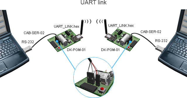

Хм, намирам готов демо код за серийна двупосочна комуникация между два модула:
[code]
// DEMO EXAMPLE
// UART - LINK
// Intended for:
// HW: - TR-52D + DK-EVAL-04
// - TR-52D + DS-UART (DK-PGM-01 with CAB-SER-02)
// OS: - v3.03D
// Description:
// This example works as UART (RS232) link. The received RF packet
// is sent via UART and vice versa.
// File: UART_LINK.c
// Version: v1.05 Revision: 25/04/2013
// Revision history:
// v1.05: 25/04/2013 Updated for OS 3.03D
// v1.04: 19/06/2012 Comments slightly changed.
// v1.03: 02/04/2012 Tested for baud rate 19200
// v1.02: 26/03/2012 Modified for OS 3.01D, not tested for baud rate 19200
// v1.01: 16/03/2011 Modified for OS 3.00.
// v1.00: 02/06/2010 First release.
#include "../../includes/template-basic.h" // system header files inclusion
// set baudrate
#define BD_9600 // BD_19200, BD_9600, BD_4800
void configure_IO(void);
void openUART(void);
void SendByteUART(uns8 tx_data);
void SendDataUART(uns8 data_len);
uns8 RxDataUART(void);
void UART_ErrorsRecovery(void);
uns8 UART_dlen;
void APPLICATION(void)
openUART(); // UART initialization
toutRF = 5;
while (1) // main loop
if (checkRF(0))
if (RFRXpacket())
pulseLEDG();
copyMemoryBlock(bufferRF, bufferCOM, DLEN);
SendDataUART(DLEN); // send DLEN bytes from bufferCOM via UART
UART_dlen = RxDataUART(); // returns number of received data stored in bufferCOM
if (UART_dlen) // if anything received via UART
pulseLEDR();
DLEN = UART_dlen;
copyMemoryBlock(bufferCOM, bufferRF, DLEN);
PIN = 0;
RFTXpacket();
TRISC.5 = 1; // pin connected with RX
TRISC.7 = 1; // RX input
TRISC.6 = 0; // TX output
BAUDCON = 0; // baudrate control setup
void openUART(void) // baudrate, 8N1
configure_IO();
// baudrate @ 8MHz, high speed
#ifdef BD_19200
SPBRGL = 25;
setRFmode(_STAYRX); // checkRF function takes less time
#endif
#ifdef BD_9600
SPBRGL = 51;
#endif
#ifdef BD_4800
SPBRGL = 103;
#endif
TXSTA = 0b00100100; // async UART, high speed, 8 bit, TX enabled
RCSTA = 0b10010000; // Continuous receive, enable port, 8 bit
void SendByteUART(uns8 tx_data) // send a byte via UART
while (TXIF == 0); // wait until bit PIR1.TXIF is cleared
TXREG = tx_data;
void SendDataUART(uns8 data_len) // send data_len bytes from bufferCOM via UART
uns8 i;
if (data_len > 64) // max. 64B from bufferCOM
data_len = 64;
for (i = 0; i < data_len; i++)
SendByteUART(readFromRAM(bufferCOM + i));
uns8 RxDataUART(void) // returns number of received data stored in bufferCOM
uns8 i = 0;
UART_ErrorsRecovery();
if (RCIF) // if anything received via UART
writeToRAM(bufferCOM, RCREG);
i++;
startDelay(2); // wait for next byte
while (isDelay())
writeToRAM(bufferCOM + i, RCREG);
i++;
if (i >= 64) // max. 64B to bufferCOM
break;
return i;
void UART_ErrorsRecovery(void) // OERR and FERR bits recovery - see PIC datasheet
if (OERR) // UART overrun recovery
CREN = 0;
CREN = 1;
if (FERR) // UART framing error recovery
FERR = 0;
[code]

Ilkor,
в предния сси пост
беше писал ,че има вариант за 'прозрачно' използване.
Такъв режим ми е по- интересен, но да се върнем на последния ти пост.
Този сорс трябва да го компилираме с нещо(1),
да го прелеем в модулите с нещо друго (2),
модулите пък са качени върху някакви носещи китове(3).
Може би (1) го има на сайта,
(2) е предполагам (ама дали?) няакакъв прост за направа кабел,
(3) е нещо също простичко - преобразуватели на нива и захранване може би?
Мразя да купувам китове, които да ми покажат как да закача RX и TX, а после да ги хвърля на тавана.
Миналата седмица 45-60 минути не успях да си отговоря на тези въпроси, и това ме отказа предните дни да чета. Сега от твоите линкове прегледах малко документи от ZIP-а на старртовия пакет.
Разбрах , че за да запиша хекс файл , ще ми трябва програматор дебъгер за 54евро+20%.
Как се дебъгва радио само с един дебъгер не ми е много ясно ,но да речем че имам късмет.
За застраховка - още един дебъгер .
По-евтино ми е да пробвам прозрачен режим, но засега не съм видял сносни описания,

Компилаторът е популярният CC5X - http://www.iqrf.org/weben/index.php?sekce=support&id=download&kat=36
Наистина за програмиране и дебъгване е необходим CK-USB-04 http://www.iqrf.org/weben/index.php?sekce=products&id=ck-usb-04&ot=development-tools&ot2=development-kits
Той всъщност е бридж от USB към SPI със стандартен CDC драйвер на Microchip. Комуникационният протокол е описан, така че при малко повече въображение предполагам че може да се измисли и друг начин за програмиране. Освен това модулите вградени в крайни устройства могат да бъдат програмирани OTA - достатъчно е само да се страртира тази функция на операционната система.
Останалите "кутийки" (DK-EVAL-04) в кита (DS-START-03) съдържат акумулаторна батерия и конектор за включване на модула и извеждане на периферията на стандартен SIP конектор.

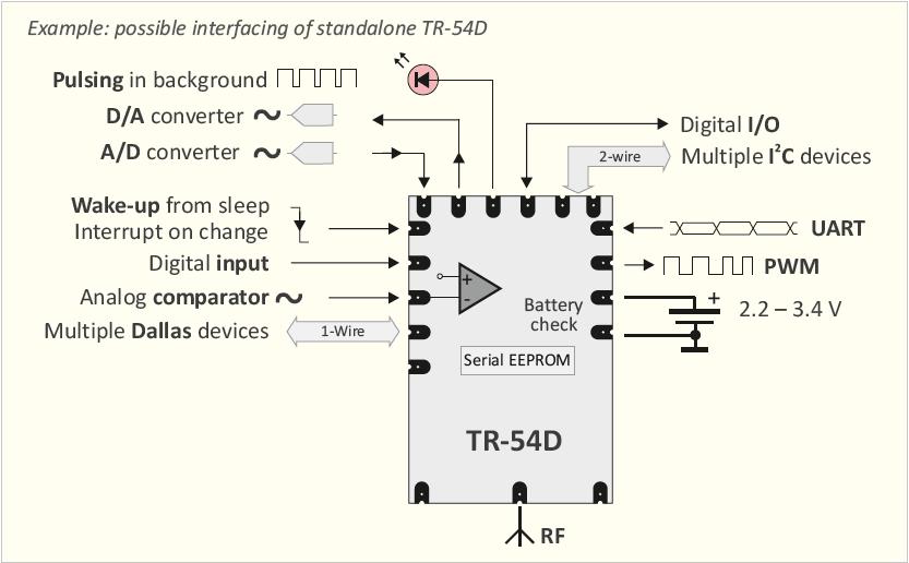

За "прозрачният" режим явно не сме се разбрали. Аз написах че модулите могат да се ползват без нужда от писане на софтуер в тях чрез използваване на Direct peripheral addressing режим. Той позволява достъп до периферията на всеки един модул в мрежата чрез стандартна команда изпратена през мрежовият координатор. Командата има изключително проста структура:
мрежов адрес на модула към който искаме да подадем команда
код указващ типа на периферията - аналогов/цифров вход/изход; PWM; UART; SPI; I2C; Temp.Sensor; EEPROM; ...
команда към избраната периферия - примерно инициализиране на UART порт-а и изпращане на поредица от байтове; задаване на коефициент на PWM; ...
Към мрежовият концентратор може да се подават команди за добавяне на нови нодове в мрежата, за проверка интегритета на мрежата ... За пренасянето на всички команди през мрежата се грижи операционната система на модулите чрез динамично рутиране.
Този режим ще бъде официално обявен през септември но аз разполагам с бета версия затова казах че мога да направя демонстрация.
Ето как изглежда периферията на един модул:
