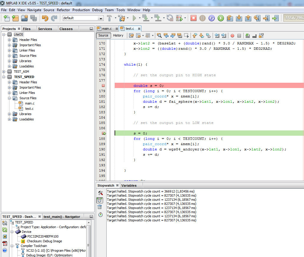

Мнение Re: Молба за тест на PIC
PIC32MZ2048EFM100
200 MHz
math default :) незнам каква е
4 мили
6 мили
4 мили
6 мили
и те така

200MHz.jpg [ 509.8 KiB | Прегледано 6767 пъти ]

тва е теста - дай нова фунция
int test_main(void)
   const long TESTCOUNT = 1000;
   const double RANDMAX = (double)RAND_MAX;
   const double DEG2RAD = M_PI / 180.0;
   pair_coord * mem = (pair_coord*)malloc(TESTCOUNT * sizeof(pair_coord));
   srand(2);
   for (long i = 0; i < TESTCOUNT; i++) {
      double baseLat = (double)rand() * 60.0 / RANDMAX;
      pair_coord* x = &mem[i];
      x->lat1 = (baseLat + (double)rand() * 3.0 / RANDMAX - 1.5) * DEG2RAD;
      x->lon1 = ((double)rand() * 3.0 / RANDMAX - 1.5) * DEG2RAD;
      x->lat2 = (baseLat + (double)rand() * 3.0 / RANDMAX - 1.5) * DEG2RAD;
      x->lon2 = ((double)rand() * 3.0 / RANDMAX - 1.5) * DEG2RAD;
   while(1) {
      // set the output pin to HIGH state
      double s = 0;
         double d = fai_sphere(x->lat1, x->lon1, x->lat2, x->lon2);
         s += d;
      // set the output pin to LOW state
      s = 0;
         double d = wgs84_andoyer(x->lat1, x->lon1, x->lat2, x->lon2);
         s += d;
   return 0;
