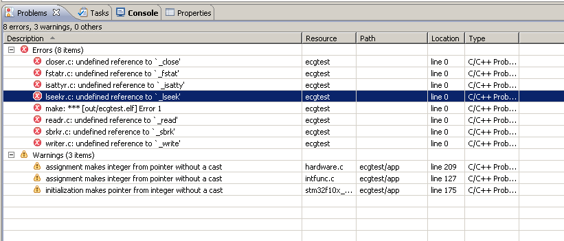

Аре ново двайсе.
Реших да включа техните библиотеки (stdio / sprintf). И си ..... мамата. Линкването отгърмя.....
Linking: out/ecgtest.elf
arm-none-eabi-gcc -mcpu=cortex-m3 -gdwarf-2 -mthumb -O0 -fomit-frame-pointer -fverbose-asm out/stm32x_lib/cortexm3_macro.o out/app/main.o out/app/hardware.o out/app/intfunc.o out/app/lcd.o out/app/screen.o out/app/stm32f10x_it.o out/app/stm32f10x_vector.o out/stm32x_lib/stm32f10x_rcc.o out/stm32x_lib/stm32f10x_gpio.o out/stm32x_lib/stm32f10x_systick.o out/stm32x_lib/stm32f10x_spi.o out/stm32x_lib/stm32f10x_dma.o out/stm32x_lib/stm32f10x_nvic.o --output out/ecgtest.elf -nostartfiles -Wl,-Map=out/ecgtest.map,--cref,--gc-sections -Tstm32x-ROM.ld
c:/armgcc/cs/bin/../lib/gcc/arm-none-eabi/4.3.2/../../../../arm-none-eabi/lib/thumb2\libc.a(lib_a-sbrkr.o): In function `_sbrk_r':
sbrkr.c:(.text+0x12): undefined reference to `_sbrk'
c:/armgcc/cs/bin/../lib/gcc/arm-none-eabi/4.3.2/../../../../arm-none-eabi/lib/thumb2\libc.a(lib_a-writer.o): In function `_write_r':
writer.c:(.text+0x16): undefined reference to `_write'
c:/armgcc/cs/bin/../lib/gcc/arm-none-eabi/4.3.2/../../../../arm-none-eabi/lib/thumb2\libc.a(lib_a-closer.o): In function `_close_r':
closer.c:(.text+0x12): undefined reference to `_close'
c:/armgcc/cs/bin/../lib/gcc/arm-none-eabi/4.3.2/../../../../arm-none-eabi/lib/thumb2\libc.a(lib_a-fstatr.o): In function `_fstat_r':
fstatr.c:(.text+0x14): undefined reference to `_fstat'
c:/armgcc/cs/bin/../lib/gcc/arm-none-eabi/4.3.2/../../../../arm-none-eabi/lib/thumb2\libc.a(lib_a-isattyr.o): In function `_isatty_r':
isattyr.c:(.text+0x12): undefined reference to `_isatty'
c:/armgcc/cs/bin/../lib/gcc/arm-none-eabi/4.3.2/../../../../arm-none-eabi/lib/thumb2\libc.a(lib_a-lseekr.o): In function `_lseek_r':
lseekr.c:(.text+0x16): undefined reference to `_lseek'
c:/armgcc/cs/bin/../lib/gcc/arm-none-eabi/4.3.2/../../../../arm-none-eabi/lib/thumb2\libc.a(lib_a-readr.o): In function `_read_r':
readr.c:(.text+0x16): undefined reference to `_read'
collect2: ld returned 1 exit status
make: *** [out/ecgtest.elf] Error 1
error1.PNG [ 25.55 KiB | Прегледано 1889 пъти ]

аз май бях гледал нещо подобно, може да провериш дали си указал да се свързват библиотеките, които правят реалното прехвърляне на данни - като гледам, това са библиотеките в директория lib/thumb2 (където си инсталирал codesourcery-то) - напр.: libcs3hosted.a, libcs3unhosted.a и другите с низ 'cs3' в името (проверих тези две библиотеки само за символ isatty - и двете съдържат този символ); подозирам, че hosted библиотеката печата през dcc и може да гледаш в дебъгера какво печаташ, а unhosted версията се ползва, може би, като си програмираш крайното изделие (не за debug) и съдържа само празни, dummy функции, за да не гърми свързващият редактор
