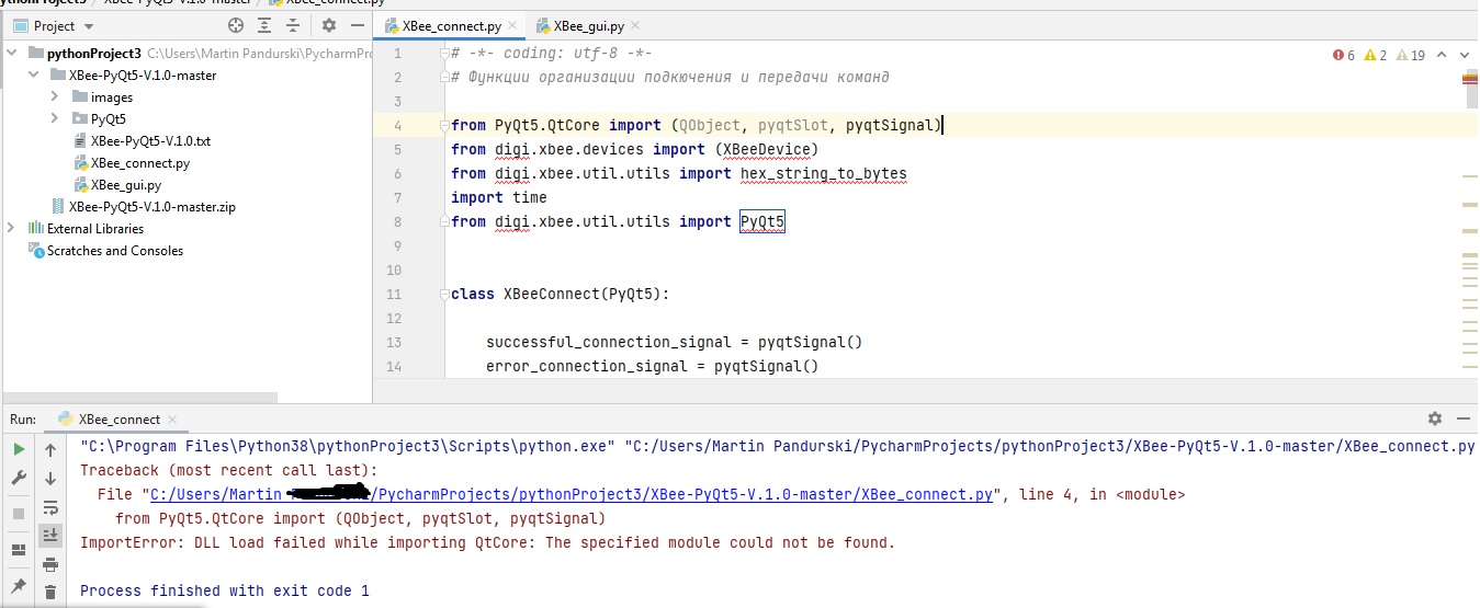

Здравейте, опитвам се да стартирам този проект(https://github.com/RuslanSdk/XBee-PyQt5-V.1.0) на Pycharm 2021 и Python 3.8. Но имам грешки.
Терминалът показва, че проблемът е в ред 4:
Той казва, че не може да импортира QtCore.
Опитвам се да инсталирам препоръките, които PyCharm ми даде (като pyQT eлементите), но когато се опитам да инсталирам digi пакетите, имам тази грешка:
Building wheels for collected packages: pyjq
  Building wheel for pyjq (PEP 517) ... error
  ERROR: Command errored out with exit status 1:
   command: 'c:\program files\python38\python.exe' 'c:\program files\python38\lib\site-packages\pip\_vendor\pep517\in_process\_in_process.py' build_wheel 'C:\Us ers\MARTIN~1\AppData\Local\Temp\tmp4ea0j0ww'
       cwd: C:\Users\Martin\AppData\Local\Temp\pip-install-0ieky1pa\py jq_c1ea8dc6d76b44adaf15bf41d84bec1e
  Complete output (23 lines):
  running bdist_wheel
  running build
  running build_py
  creating build
  creating build\lib.win-amd64-3.8
  copying pyjq.py -> build\lib.win-amd64-3.8
  running build_ext
  RefactoringTool: Refactored C:\Users\Martin\AppData\Local\Temp\pip-install -0ieky1pa\pyjq_c1ea8dc6d76b44adaf15bf41d84bec1e\dependencies\onig-6.9.0\src\gperf_fold_key_conv.py
  RefactoringTool: Files that were modified:
  RefactoringTool: C:\Users\Martin\AppData\Local\Temp\pip-install-0iek y1pa\pyjq_c1ea8dc6d76b44adaf15bf41d84bec1e\dependencies\onig-6.9.0\src\gperf_fold_key_conv.py
y1pa\pyjq_c1ea8dc6d76b44adaf15bf41d84bec1e\dependencies\onig-6.9.0\src\make_unicode_egcb_data.py
  RefactoringTool: Refactored C:\Users\Martin\AppData\Local\Temp\pip-install-0ieky1pa\pyjq_c1ea8dc6d76b44adaf15bf41d84bec1e\dependencies\onig-6.9.0\src\make_unicode_fold_data.py
RefactoringTool: Refactored C:\Users\Martin\AppData\Local\Temp\pip-install-0ieky1pa\pyjq_c1ea8dc6d76b44adaf15bf41d84bec1e\dependencies\onig-6.9.0\src\make_unicode_property_data.py
  error: [WinError 2] The system cannot find the file specified
  ERROR: Failed building wheel for pyjq
Failed to build pyjq
ERROR: Could not build wheels for pyjq which use PEP 517 and cannot be installed  directly
Търсих инфо за грешката Building wheel for pyjq, но не ми стана ясно как точно да я инсталирам на Win 7 ?

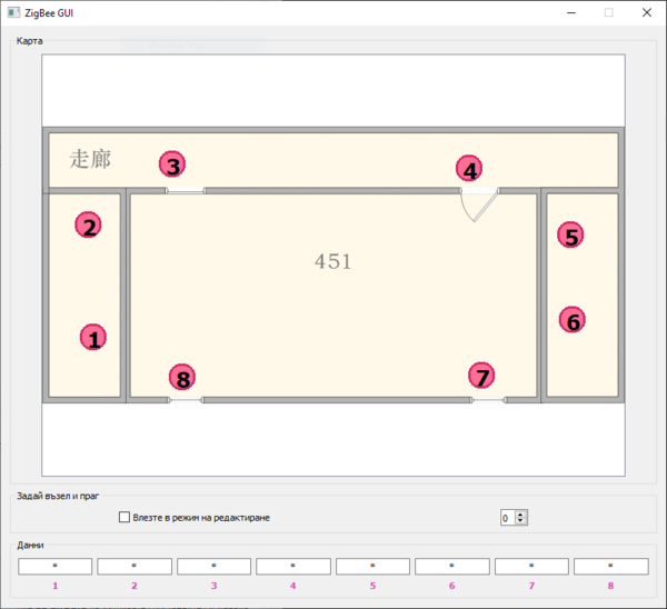

Здравейте, опитвам се да стартирам този проект (подобен на предишния) (https://github.com/zzeitt/ZigBee-GUI), но не мога да разширя полето с картата, а също и не мога да видя част от приложението така, както е показано на примера от снимката, някаква помощ?

Мнение Re: PyQT5 + PyCharm + Xbee

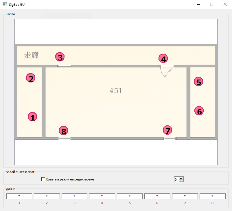

Нещо сигурно си забърсал като си преименувал лейбълите. Сега тествах при мен и си се показва както трябва.
Боза 10, змия 3.8.1

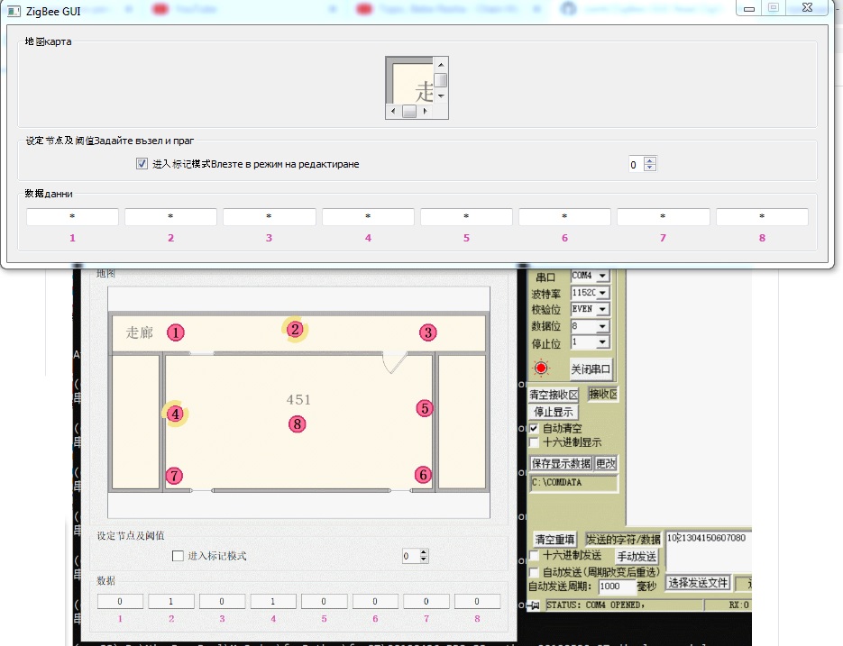

Не съм преименувал. Ползвахте ли някакъв допълнителен Serial Debug Assistant за да тествате?
Оригинала на мен ми даваше много грешки и трябваше редакции, може така да съм объркал нещо. Сега го оправих някак (картата се показва в нормален размер) (като пред реда за размер сложиш #), но ми излиза някакво съобщение, че картата/прозореца не е заредена правилно. Сега незнам дали работи както трябва, защото използвах това приложение (https://github.com/Neutree/COMTool) + моите Xbee/Zigbee модули, но на картата не излиза нищо. Също така смених номера на СОМ-порта, но ми излиза, че не е зареден правилно (със стария дава същото).
Някакви идеи какво да правя ?

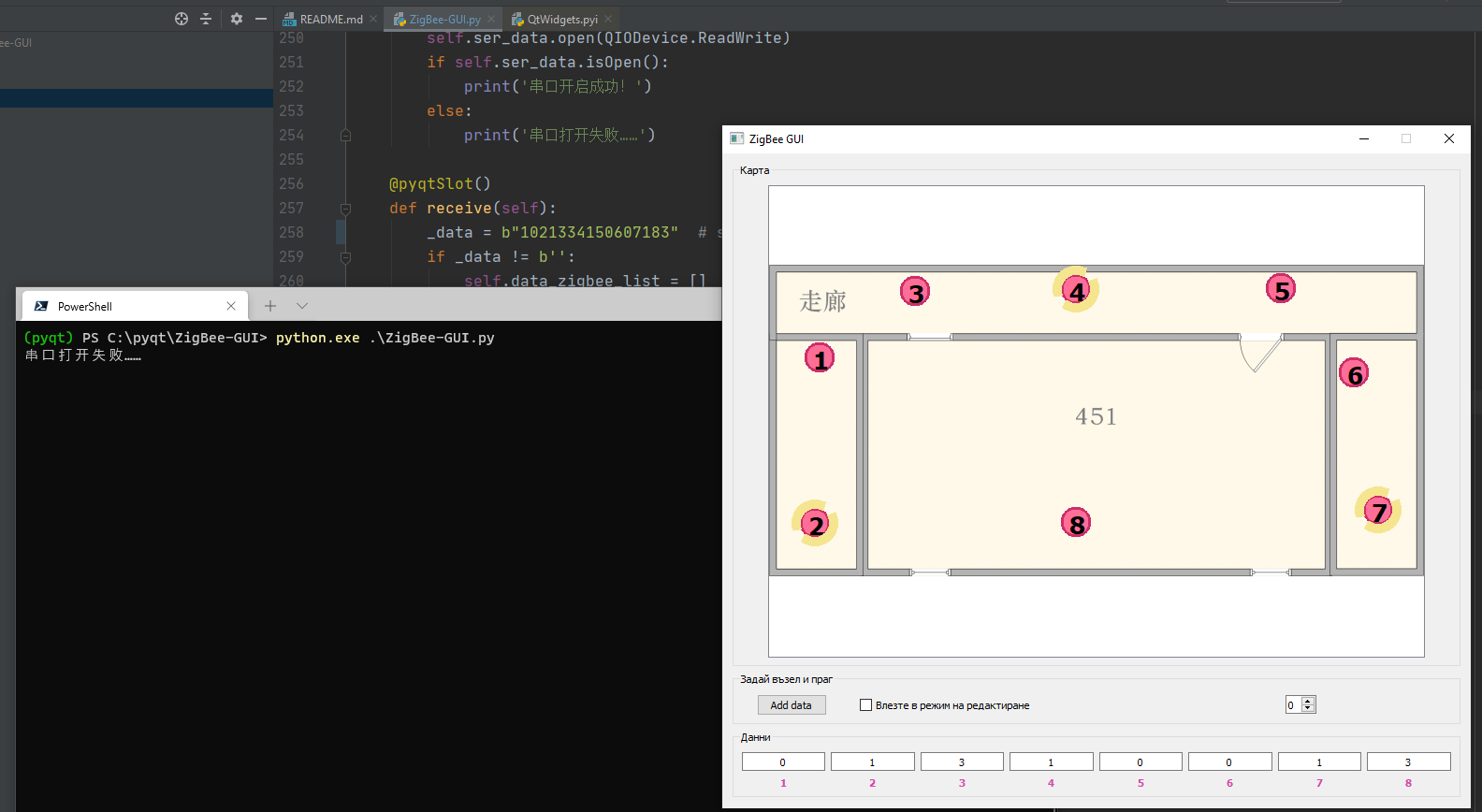

Мнения: 1730
За серийният порт нищо не мога да кажа. Не съм уиндоус потребител и нямам идея какво е модерно и работещо в момента. Честно казано и желание нямам да цапам бозата със съмнителен софтуер. Поиграх си малко все пак - добавих бутон, който да емулира идващи данни по серийният порт. Като гледам - успешно си ги обработва и показва на екрана. Имаше само една уловка - чекбокса за редакция трябва да е изключен за да се обнови каквото и да е от подадените данни. Към това приложение няма грам документация. Формата на данните си го изкарах от кода - трябва да се пуснат 16 байта, като това са само числа в ASCII формат. Първото число на всяка двойка ти е номера на у-вото (1 до 8 ) а другото - стойността която се показва в апп-а. Примерно "1021334150607183". Това последното ти го пиша, за да си сигурен какво точно подаваш като данни от твоите у-ва.
